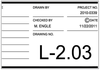

Sheet Number Format and Location for Non-Capture Areas
The following guidelines are for formatting sheets numbers when a template isn't selected in the extraction process. Automatic OCR occurs when the system will attempt to read the sheet number from the title block.
| Location | In the title block at the bottom right corner of a landscape format drawing. |
| Text orientation | Horizontal text which reads from left to right. |
| Font size | Larger font size compared to the surrounding text. |
| Font type | Standard or common font with continuous, filled-in bold characters. There should be white space between each character. ![]() Avoid italics, stencils, or fonts which look like handwriting. Try not to write or draw anything on top of (or right next to) the sheet number. Ideal example of a sheet number in a title block: ![]() |

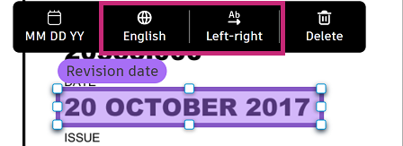

Custom Attribute Value Format
The most important settings for custom attribute extraction are the orientation and language set on the capture area in the title block. Vertical or non-English text values will not be read correctly if the options are not set correctly. This is relevant for drawing capture areas, either in templates or during extraction.
Revision number: Add the current revision number directly in the title block in a manual area drawing, either in templates or on the fly. Addition to the revision block. This means you can always extract the latest revision information.
See Add and Capture Title Block Attributes for more details on how to add attributes, draw capture areas, and check the orientation and language settings.
