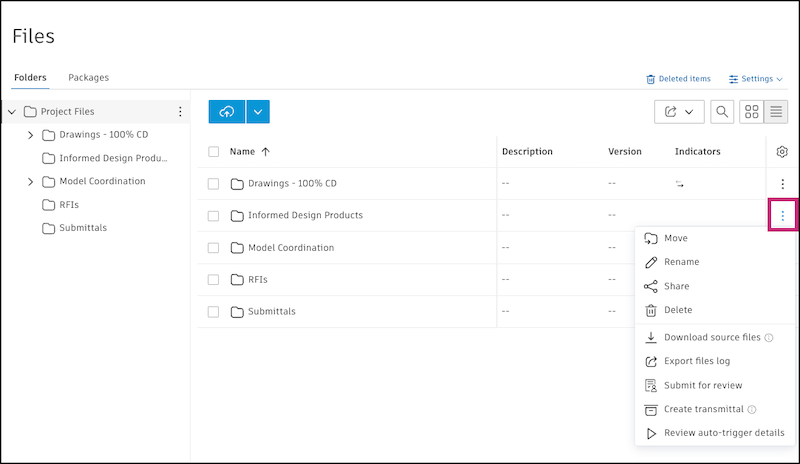

  3. Find the folder in the Files tool in ACC.
    Important: Informed Design products aren't listed in Docs. To confirm which products are available in a particular folder, go to the Releases tab in the Informed Design Web Portal and refer to the Folder column.
  4. Click the More menu icon More menu icon next to the folder that you want to share.
  5. Select Share.

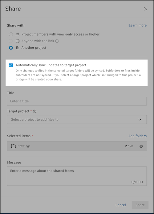

  6. Under Share with, select Another project.
  7. Select Automatically sync updates to target project.
    Important: This option must be selected when sharing folders with Informed Design products.
  8. Select the target project and folder (if available). Title and message are optional. Learn more in the Files help about sharing and what projects appear here.
  9. Click Share.
