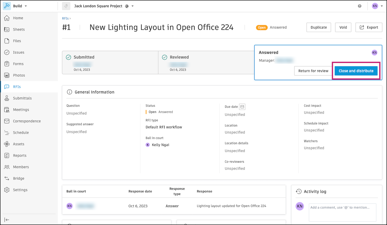

As a Manager in the RFIs tool, click Close and distribute on an RFI that is complete.

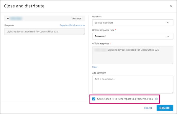

In the Close and distribute window, select Save closed RFIs item report to folder in Files.

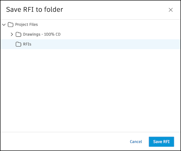

Select a folder in the Files tool to add the RFI to and click Save RFI.

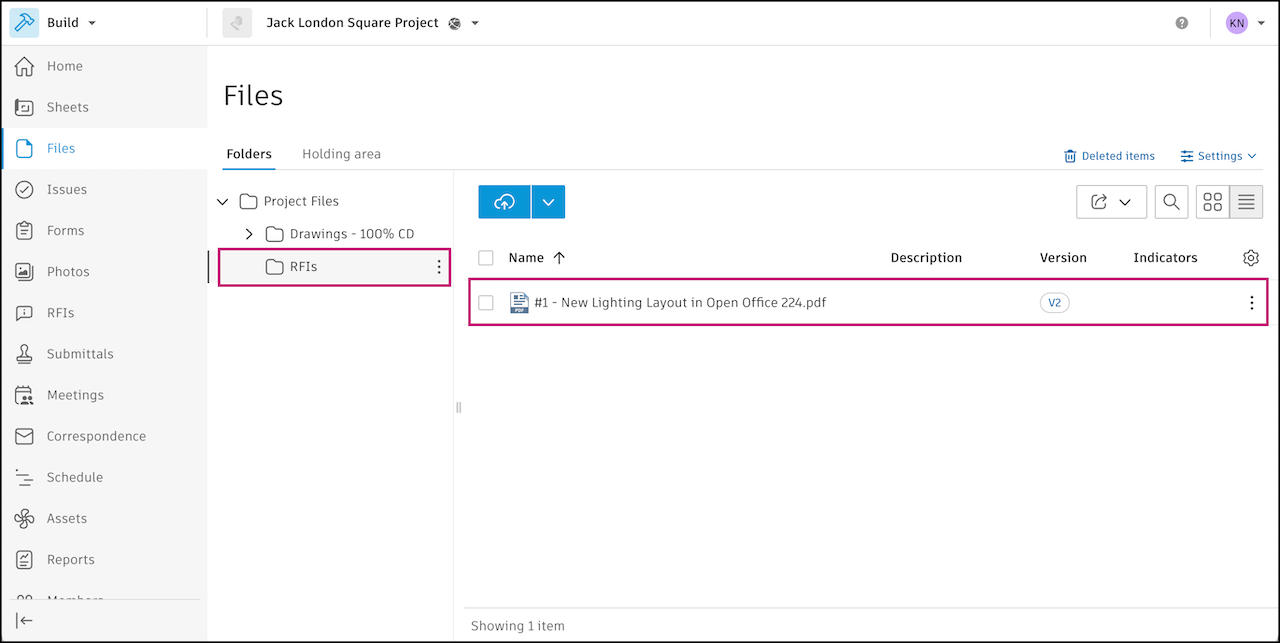

In the Files tool, find the selected folder and the RFI you shared.

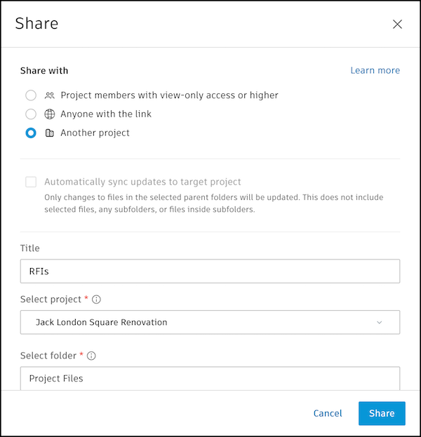

Select Share.
Under Share with, select Another project.
If you selected to share a folder, you can set up a folder automation where any updates to the folder will automatically sync to the project you are sharing with. This feature is not available for individual files.
Enter a title (optional). This will identify the items you have shared when you manage this in the Bridge tool.
Select the project and folder that you want to share the RFIs with.
Note: You can review what permissions are required to share in Bridge Permissions.Review the items you will be sharing. Click Add folders to add additional folders you want to share or click
next to any items you no longer want to share.
Click Share.

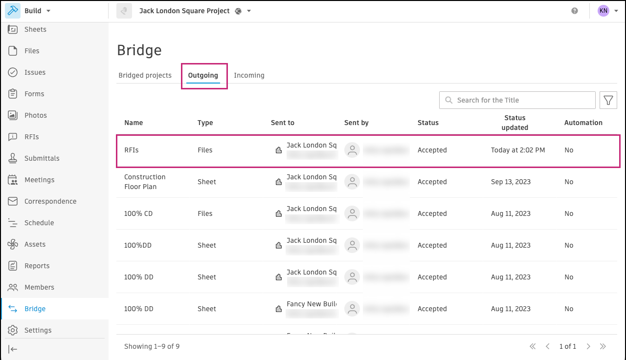

Now, in the Bridge tool, you can track what was shared in the Outgoing tab. Click the line item to see what was shared and for more details.
If you did set up an automation, a bridge was created between your project and the selected project. You can manage this bridge and any automations in the Bridged projects tab. Learn more about managing automations in Bridge Automations.
