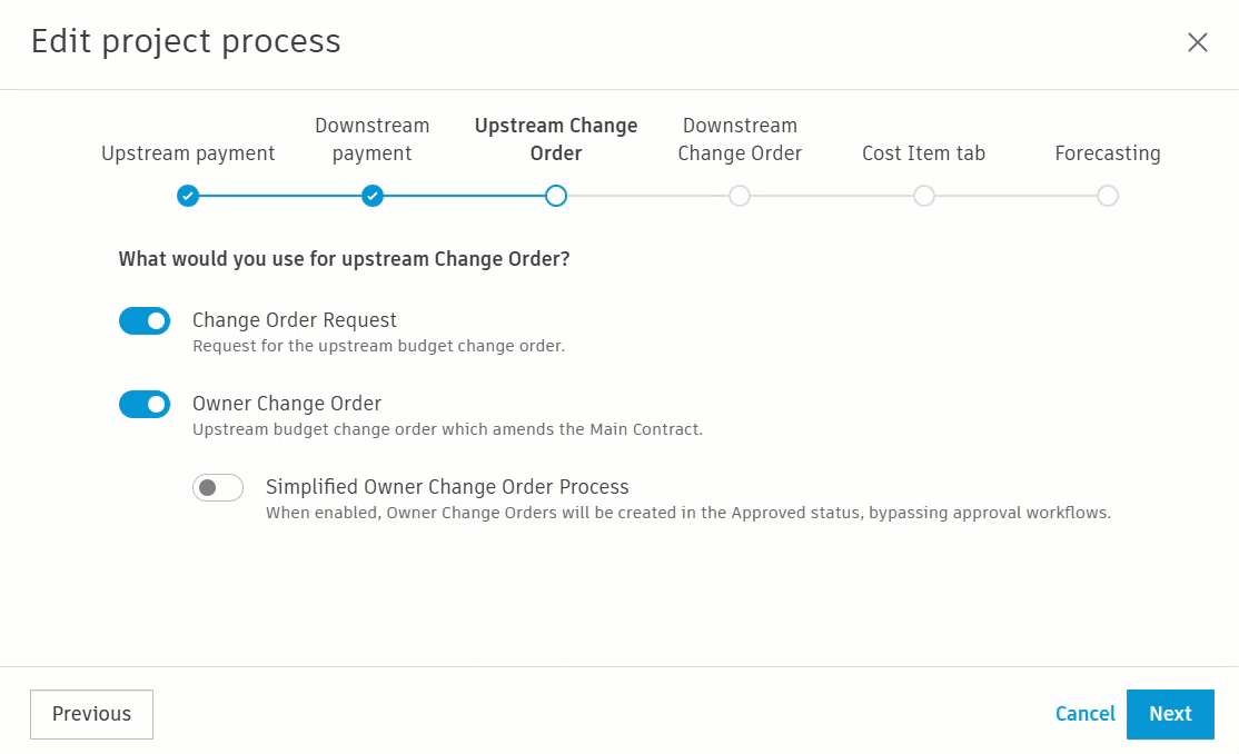

To enable the simplified change order process:
  1. Select the Settings tool from the left navigation.
  2. Switch to the General tab.
  3. Go to Project Process and click Edit.
  4. Navigate through the wizard to Upstream change order or Downstream change order.
  5. Enable the desired toggle:
    • Simplified Owner Change Order Process
    • Simplified Supplier Change Order Process
  6. Click Save.
Simplified change order process toggles in project process settings
