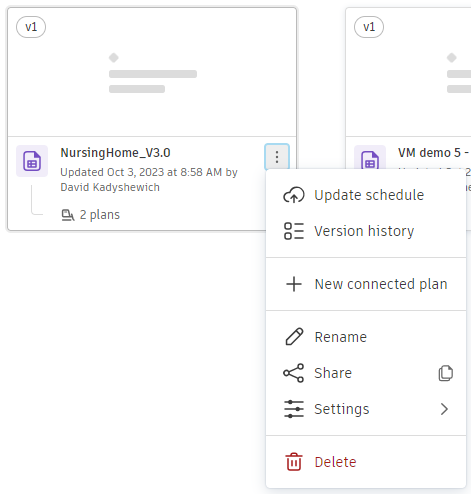

There are several ways to create plans connected to a schedule.

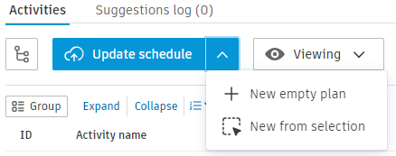

Use the main view.
Open the desired schedule, then click New empty plan.

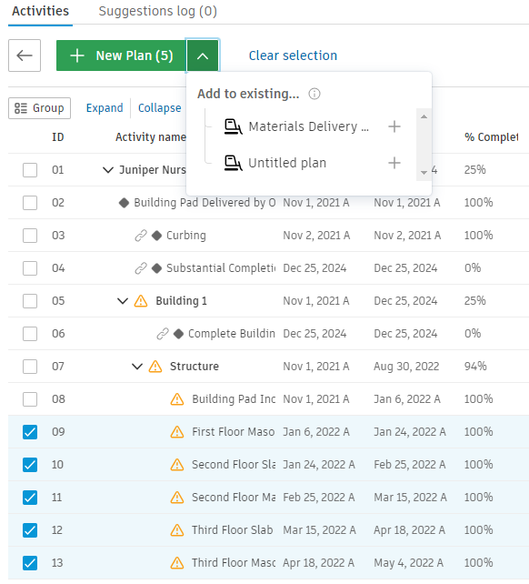

Select activities from the timeline by checking the boxes next to them, then click New Plan, or add them to the existing plan.

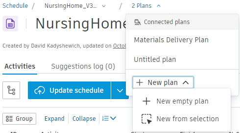

Use the breadcrumbs.

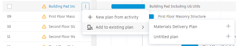

Use the quick menu available for each activity.

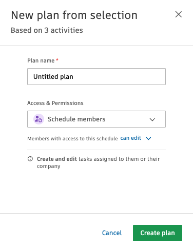

To finalize creation:
- Enter a name for the plan.
- Modify plan settings, such as access and permissions.
- Click Create plan.
This will establish a new plan with tasks tied to the chosen schedule activities. Any modifications to the linked schedule activities will be updated in the plan tasks.
