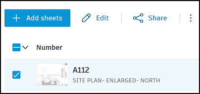

Access Sheet Editing
Select the relevant sheet or sheets.
Click Edit.

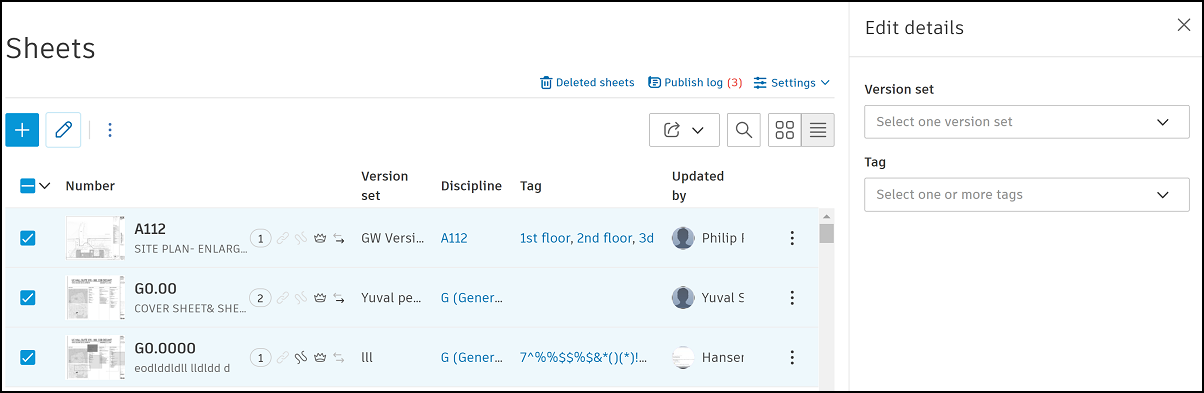

You can now edit the following sheet details:
Individual sheets: Edit the sheet number, title, version set, and tags.
Multiple sheets: Edit the version set and tags only for all selected sheets.

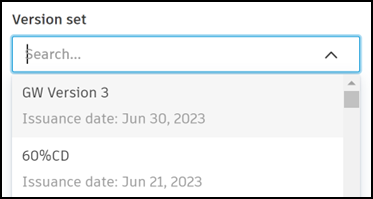

Change Version Set After Sheet Publication
You can edit the version set for individual or multiple sheets.
Click the Version set field.
Select a version set from the dropdown list. You can also start entering the name of a version set to bring up suggestions.
Autocallout links always point to the current sheet version. Changing the version set of means the autocallout links will no longer work if the version set is no longer the latest version.

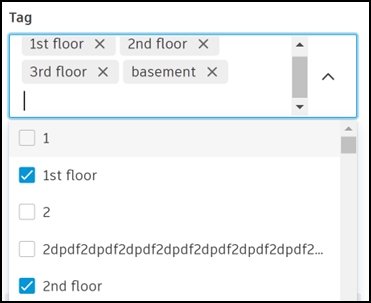

Add and Remove Sheet Tags After Publication
You can add and remove tags for individual or multiple sheets.
Remove: Click X next to the relevant tag to remove it.
Add: Click the Tag field and select tags to add them to the sheet. You can also start entering the name of a tag to bring up suggestions.
Create: Click the Tag field, enter the text of your new tag and press enter or click Create option.
After you've made your changes to sheet details, click Save.
