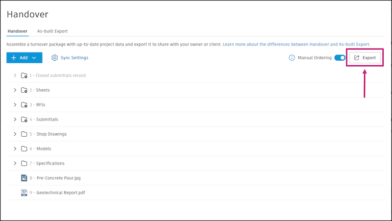

You can export the package you assemble in Handover to send to any external stakeholders.
Click Export. A ZIP file of your handover package will be emailed to you when it’s ready.
