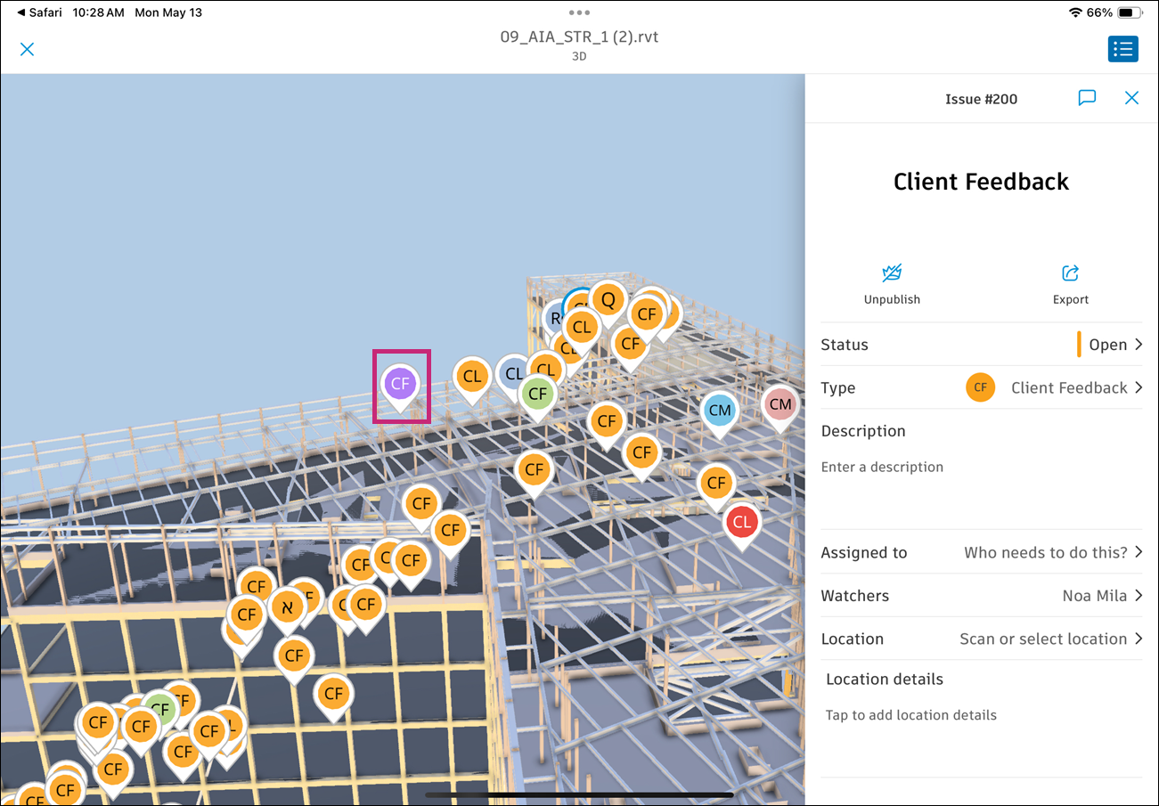

Work with Issues Placed on 3D Models in the Viewer on iOS BETA
Note: This feature is now available in public beta. The functionalities described are what is available during this phase. See BETA Viewer on Mobile for more information.
You can place your issue on a 3D model when creating issues in web.
  1. Follow steps 1-6 given above to open your issue in the viewer.
  2. The following gestures are available: Zoom, Pan, Look around, and Rotate.
  3. Tap Turn on BETA viewer! at the top of the screen to access the new functionality and view issues placed on a 3D model.
    Issue pins indicate places where issues have been placed on a model.
  4. Tap the desired issue pin to view and edit details of this issue, export, delete, publish, or unpublish your issue.

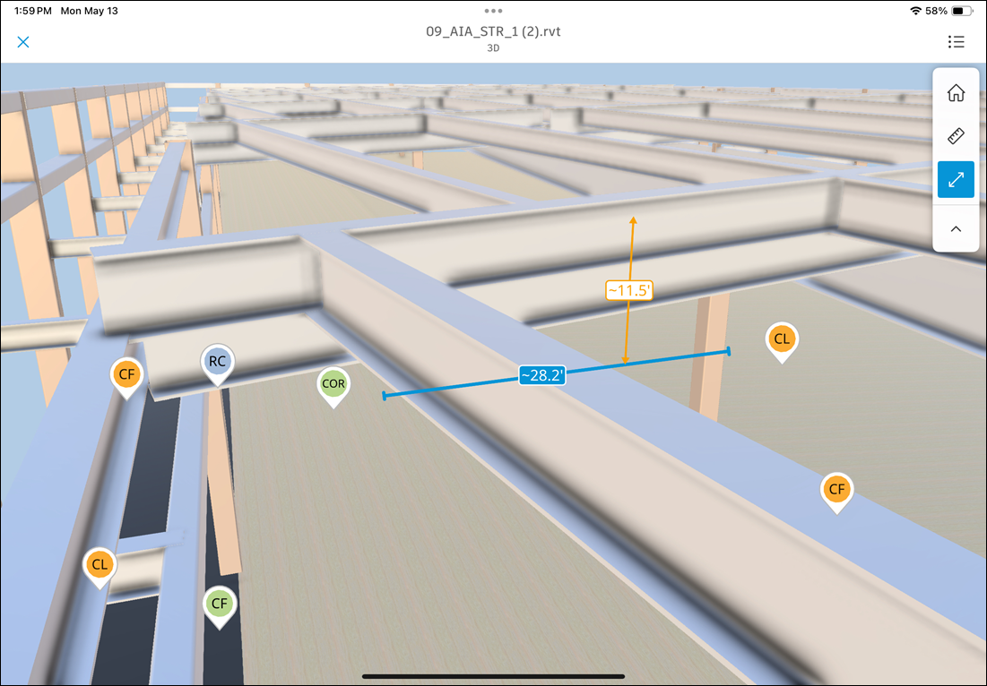

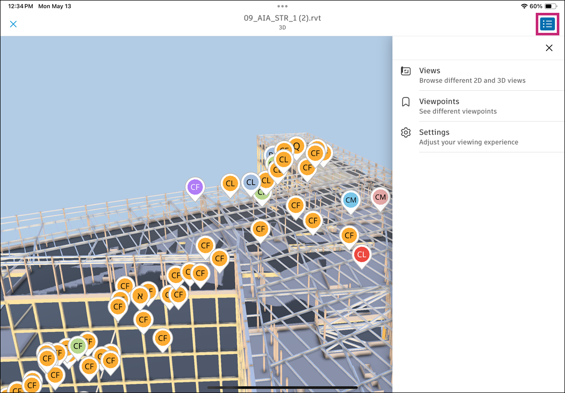

  • Tools: The following numbers correspond to the numbers in this screenshot.
    1. Menu: Tap the menu to access the following:
      • Views: View any 2D or 3D views associated with your model
      • Viewpoints: View any 2D or 3D views associated with your model
      • Settings:
        • Review the hand gestures
        • Hide the BETA viewer banner
        • Send BETA feedback
    2. Home view: Tap to return to the default view.
    3. Measurement: Tap two points on your model to measure the distance between them.
    4. Distance: When this option is turned on, anything you click in the model will get a measurement.
    5. Collapse: Tap to collapse the toolbar.
