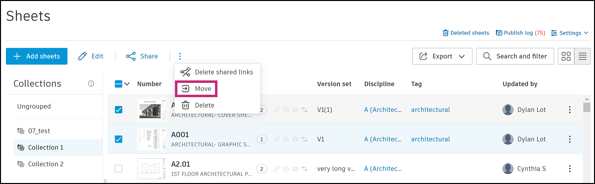

Click the Files tool.
Select either Ungrouped or the relevant collection in the Collection section.
Select the sheets you want to move.
Click the More menu
above the sheets list.Click Move.

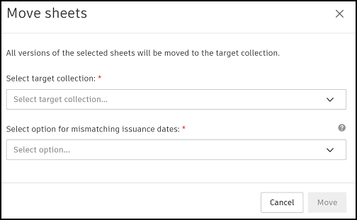

You can select a target collection and an option if your sheet version sets also exist in the target collection and their issuance dates don't match.
Select the target collection.
Note: You can't move sheets to Ungrouped or to the collection which already contains the sheets.All of your sheets will already belong to version sets in the source collection. The target collection may contain version sets with the same names as the source version sets. The issuance dates for these same source and target version sets may be different.
Select one of the following options if the sheets you are moving have version sets with the name but different issuance dates in the source and target collection.
- Move sheets with mismatching issuance dates: When moved, the sheets will adopt the issuance date of the version of the same name in the target collection.
- Don't move sheets with mismatching issuance dates: Any sheets whose version set issuance date is different in the source and target collection won't be moved.
Click Move.
