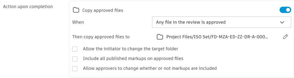

Action Upon Completion
Specify whether you want to copy approved files to another folder, add and update attributes, and require the approver to enter attribute values before submitting the review.
Copy approved files: Turn on if you want to copy the approved files to a folder upon completion.
When: Choose when the approved files are copied. Either when Any file in the review is approved or All files in the review have been approved.
Then copy approved files to: Select the folder you want the files to copy to. This can include a naming standard enforced folder.
Note: The folder the files are copied to must belong to the same top-level folder as their original location.Allow the initiator to change the target folder: Select to allow the initiator to change the folder the approved files are copied to. This is useful if, for example, a selection of files need to be moved to a different folder.
Include all published markups on approved files: Select so published markups on approved files copy to the target folder. This can be overridden if you allow the option below and the approver chooses not to include markups.
Allow approvers to change whether or not markups are included: Select to allow the approver choose whether or not published markups on approved files copy to the target folder.

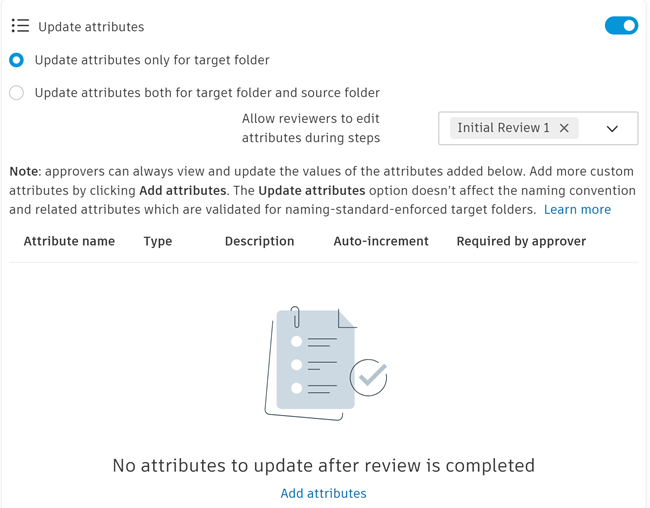

Update attributes: Turn on if you want the displayed attributes, or the added attributes, to update on completion.
Update attributes only for target folder: Select if you only want the attributes in the target folder to update.
Update attributes both for target folder and source folder: Select if you only want the attributes in both the target folder and source folder to update. You can also choose to Allow approvers to choose whether the attributes of rejected files are updated for the source folder.
Allow reviewers to edit attribute values in the following steps: Select which steps reviewers can edit attribute values. You can select no steps, one or more steps, or all steps.
Add attributes: Click this text link to add custom or related attributes on completion of each review initiated from this approval workflow.
Note: If you have chosen a naming standard enforced folder as the target folder to copy approved files to, the Status and Revision related attributes are added automatically.Once attributes are added, you can turn on Required by approver so the approver must enter a value for the selected attributes to submit the review. When Auto-increment is turned on, this automatically updates the drop-down list attributes with the next value on the list.
