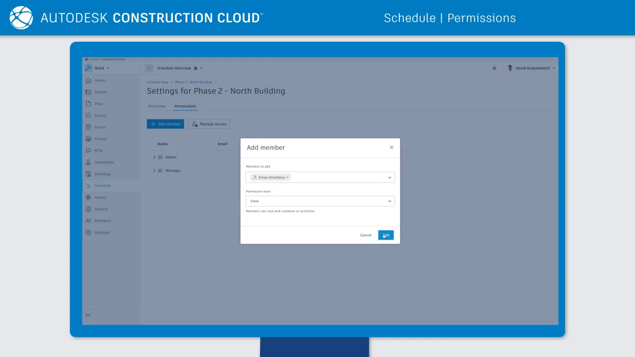

Add New Members
  1. Click Schedule from the left navigation to open the Schedule tool.
  2. Click the More menu and choose Schedule > Permissions.
    Tip: When viewing a schedule you can click the Schedule settings menu and choose Permissions.
  3. Click Add member to add a new member.
  4. Select individual members, roles, or companies to add.
  5. Choose the permission level for the added members.
  6. Click Add.

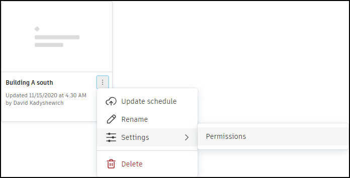

Update Member Permissions
  3. Locate the member from the list and select a new permission level. If the member is a project administrator, you can't change their Schedule tool permissions.

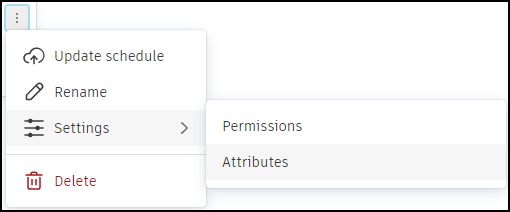

Schedule Attributes
Control sensitive information by choosing which schedule attributes are available to all members and which are available only to members with adequate permissions. To control the attribute:
  2. Click the More menu on the schedule thumbnail and choose Settings > Attributes.
  3. Turn on or off the attributes that are available to project members. Available attributes include:
