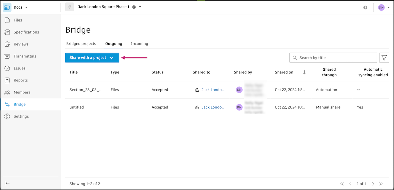

  1. Select Build in the product picker.
  2. Navigate to the Bridge tool using the left navigation menu.
  3. Click the Outgoing tab.
  4. Click Share with a project.
    Share with a project button in outgoing tab

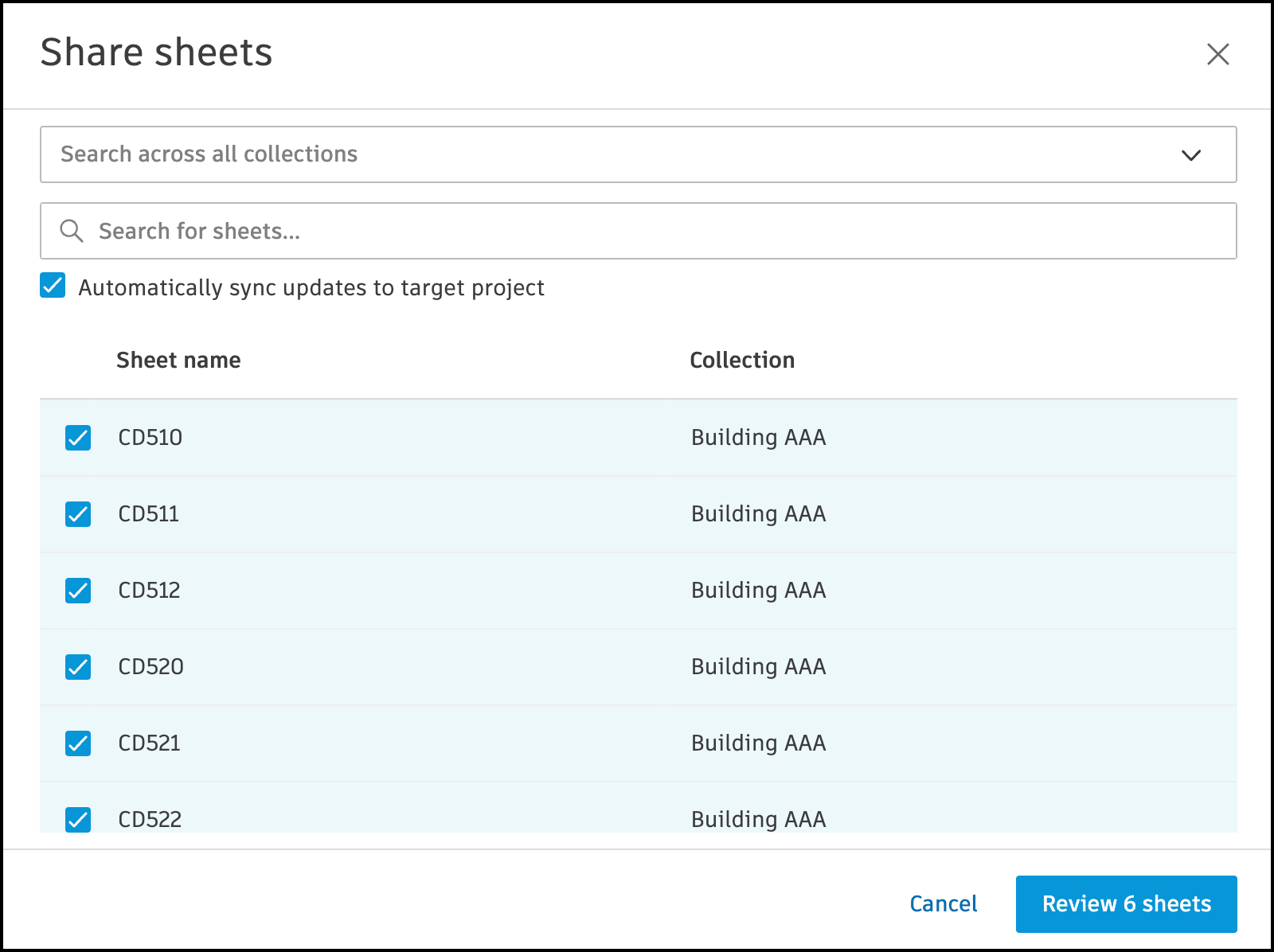

  5. Select Sheets.
  6. If your project uses collections, you can select to search from a specific collection.
  7. Use the search field to search for a sheet by name.
  8. Check Automatically sync updates to target project if you want to create a sheet automation. If the sheets you share in the source project are updated, they will automatically update in the target project.
  9. Select sheets from the list.
    Share sheets interface
  10. Click Review # sheets.

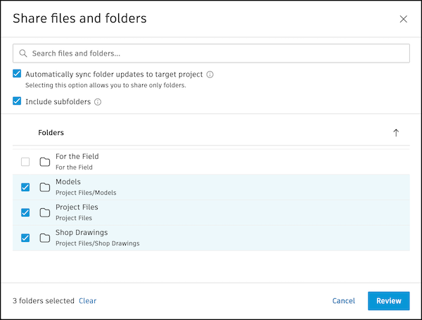

Share Files and Folders to Another Project from Bridge
  1. Navigate to the Bridge tool using the left navigation menu.
  2. Click the Outgoing tab.
  3. Click Share with a project.
  4. Select Files and folders.
  5. Use the search field to search for files or folders by name.

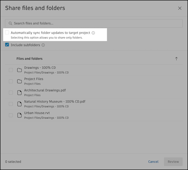

  6. (Optional for folders only) Select Automatically import folder updates into target project to create a folder automation. In a folder automation, the target project receives updates when you make updates to the selected folders in the source project. This feature helps make sure that the stakeholders you shared the folders with will always automatically have the most updated files.
    Note:
    • Automations can't be created on individual files.
    • When you create a folder automation and the project you are importing from isn't bridged to the current project, a bridge will be created. The project will appear in the Bridged projects tab in Bridge and you can manage automations in the Bridge tool.
    • New subfolders created in the source folder after the initial share won't be automatically synced to the target project. You will need to share those new subfolders separately if you want them to be synced.
    Share files with automation options
  7. (For folders only) Include subfolders will be selected by default. All subfolders within the selected folders will be shared. You can deselect this option if you want to only share the parent folders you select.
  8. Select files or folders that you want to share.
