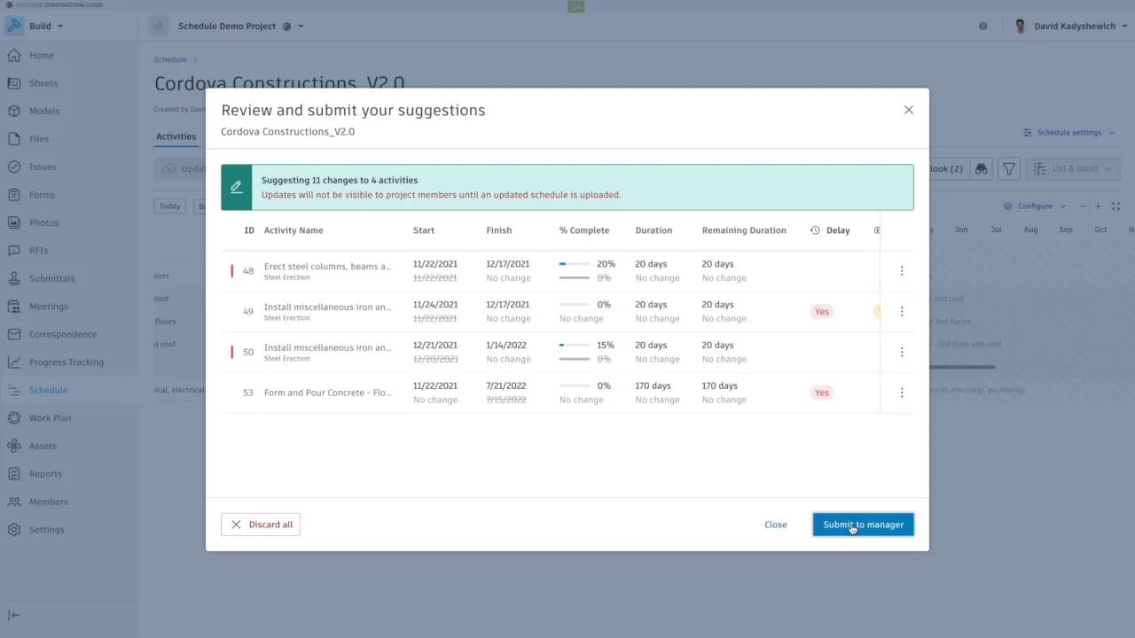

Submitting Update Suggestions
To review all update suggestions:

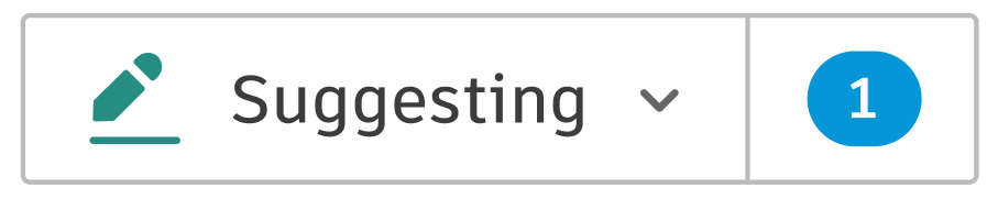

- Click the number next to the Suggesting drop-down list
. - Conveniently review all your update suggestions using the Review your suggestions window.
