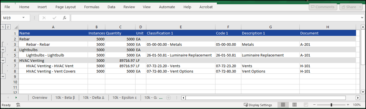

Example XLSX inventory report

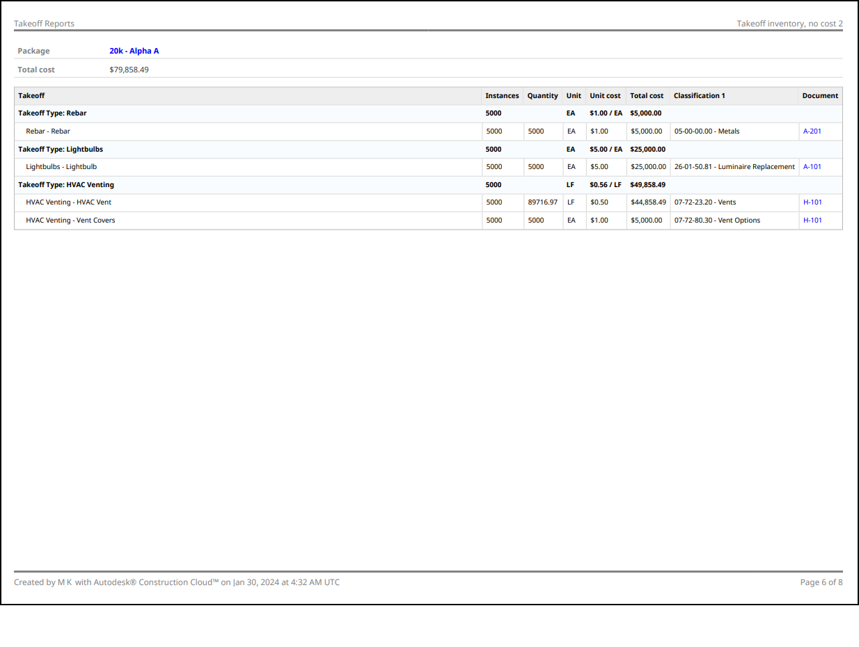

Example PDF inventory report

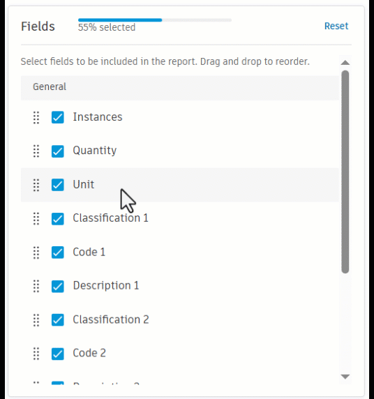

When creating an inventory report, you can choose which fields you want to include in your report. You can also control the order of those fields.
Customize the takeoff data that you want to show in the report, including or excluding the following fields (if available):

Sort the inventory data for the report in ascending order or descending order by:

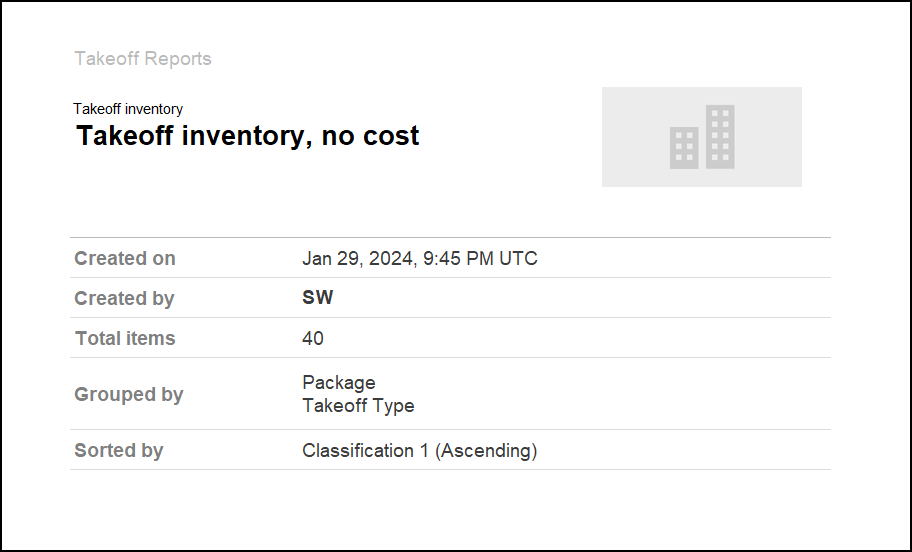

  • Cover page - Details about the report, such as organization logo (if desired), project and report name, created on/by, total items, group/sort/filters applied, report currency (if applicable)
    Example:

Select fields to be included in the report, and drag them to reorder as needed.
