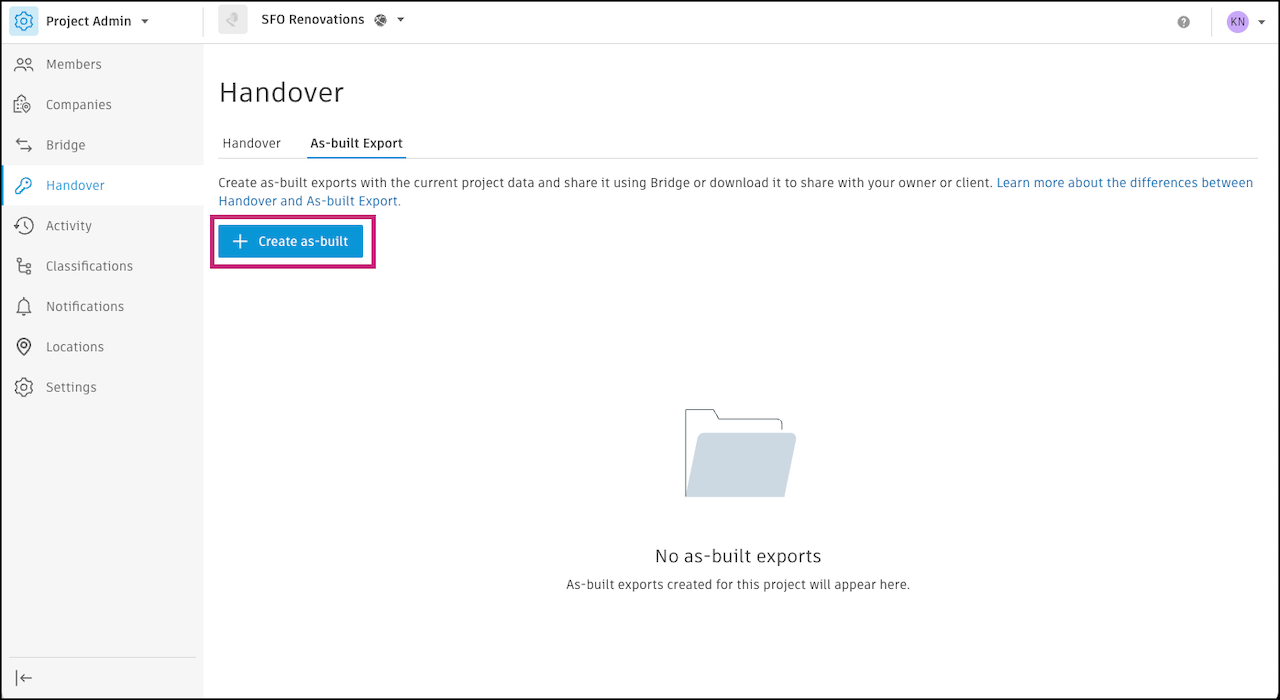

  1. Navigate to Project Admin.
  2. Click Handover in the left navigation menu.
  3. Click the As-built export tab.
  4. Click Create as-built to configure an as-built export.

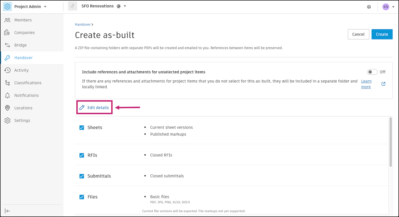

  5. The following default options are preselected. These are the project items that are supported for an as-built export:
    • Sheets - current sheets versions and published markups
    • RFIs - closed RFIs
    • Submittals - closed submittals
    • Files - current file versions for basic file types (PDF, JPG, PNG, XLSX, DOCX), not including markups
    • Issues - closed issues
    • Forms - open, closed, and archived forms
    • Photos - all photos
    Click Edit details to deselect any items you don't want to include in the as-built, or to change the configurations.

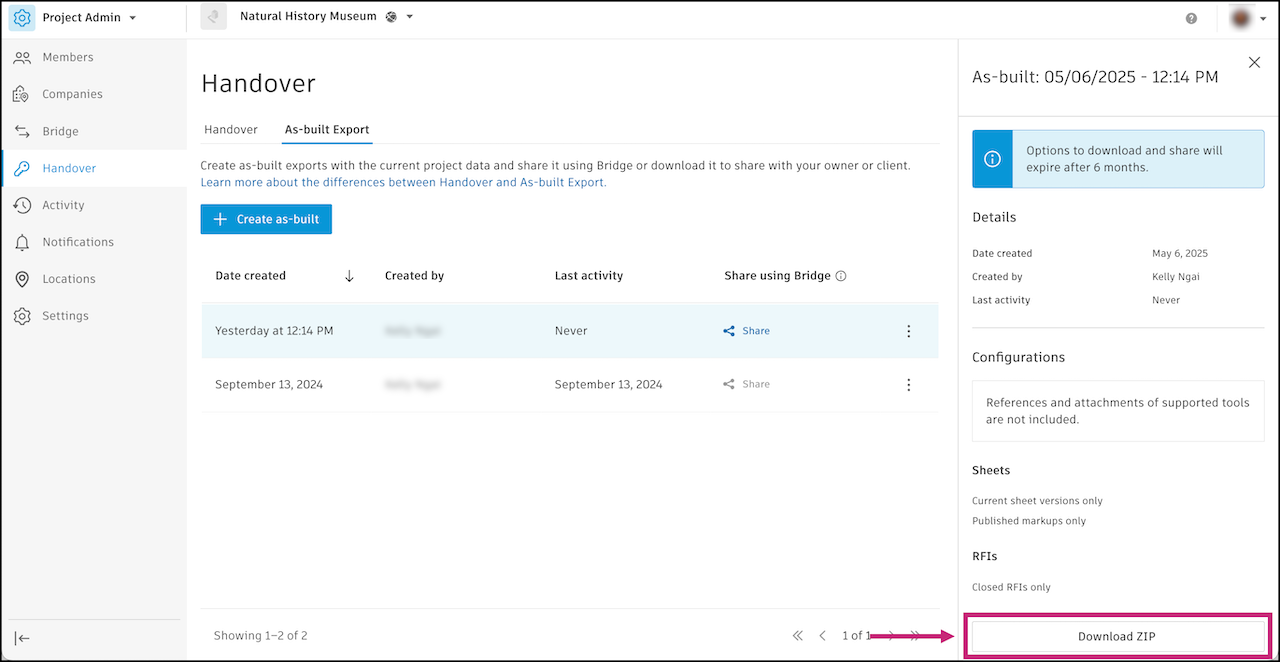

Download As-built Exports
After an as-built export has been created, the download link is available in the As-built Export log.
  1. On the As-built Export page, click the as-built and a panel will open.
  2. Click Download ZIP at the bottom of the panel.
    Download zip
