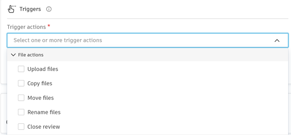

Triggers
You can select one or more file actions and file attribute trigger actions and the folders which are affected by the triggers. You can select triggers with or without conditions.
Trigger actions
Click the Trigger actions field and choose one or more of the file actions as required.
Files actions
  • Upload files
  • Copy files
  • Move files
  • Rename files
  • Close review
File attribute actions
This section lists custom and naming standard attributes in the project. You can select one or more attributes to automatically trigger a review when the selected attribute values are edited.

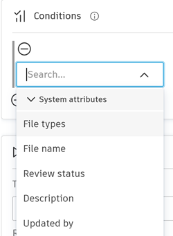

Conditions
By default, no conditions are added. This means that any of the selected trigger actions will start a review in the selected folders.
A condition consists of three parts; an attribute, operator, and value. For example:
  1. Click
    You can add an attribute to a condition using:
    • System attributes: You can select File type, Review name, Review status, Description, and Updated by system attributes.
    • Custom attributes: You can select custom attributes except date type attributes and text field attributes set as character type numeric.
    1. Click the drop-down and select a system or custom attribute as necessary.
      When you select an attribute, the operator field will display.
    2. Click the operator drop-down and select an operator from the following.
      When you select an operator, the value field will display.
    3. Click the next field and either enter a value if the attribute is a text field type, or select a value if the attribute is a drop-down list type.
    4. Add more conditions as necessary.

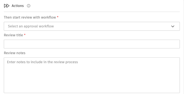

Actions
  1. Select the desired review approval workflow.
  2. Enter a title for the review.
  3. Enter any notes for the review as necessary.
    Note: The member who triggers the approval workflow (for example, they upload files or change attribute values to match the trigger conditions) will be the initiator of the review even if they do not have initiator permission for the selected approval workflow.

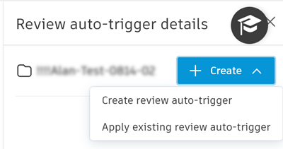

Review Auto-Trigger Details
You can select a folder from the Files tool and use Review Auto-Trigger Details to view the names of the review auto-triggers applied to that folder.
Project administrators can also create, apply, edit, remove, and delete review auto-triggers from the Review Auto-Trigger Details panel.
To access Review Auto-Trigger Details:
  1. Click the More menu of the relevant folder.
  2. Click Review auto-trigger details.
    This opens the Review Auto-Trigger Details panel:
Create review auto-trigger
  1. Click Create.
  2. Click Create review auto-trigger from the drop-down list.
  3. Follow the steps listed in the previous Create Review Auto-Triggers section.
