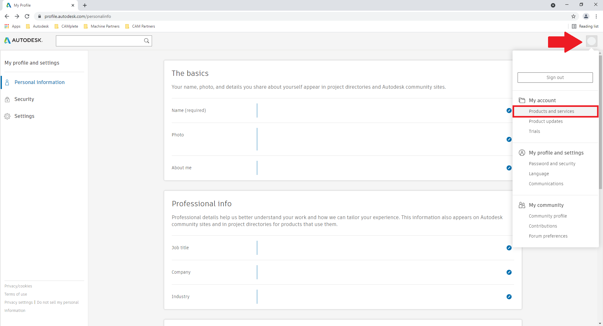

  2. Click on your profile icon in the top/right of the screen and select Products and Services.
    images

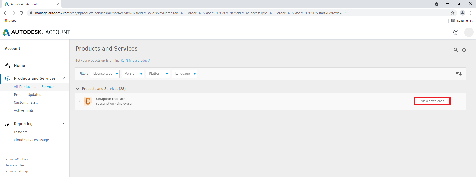

  3. Click View Downloads under CAMplete TruePath.
    images

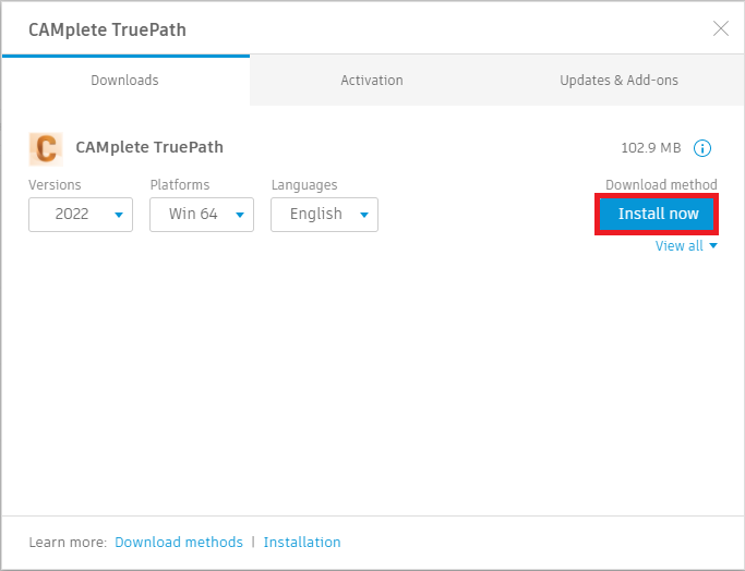

  4. Click “Install Now”.
    images

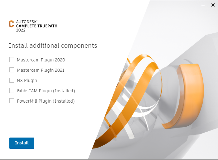

  5. Follow the prompts to install the software. When installing the software, you will be prompted to install CAM system plugins. If a plugin is available for your CAM system, you can select it during the installation process.
    images
