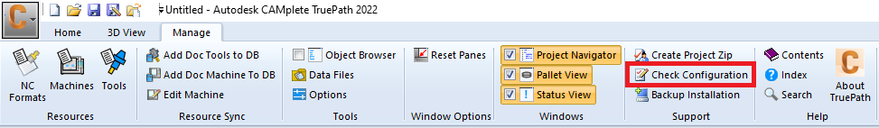

  3. In the ribbon, go to Manage > Support > Check Configuration.

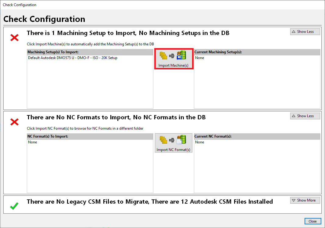

  4. Click Import Machines.
    images
  5. Once the machine moves to Current Machining Setup(s), click Close.
