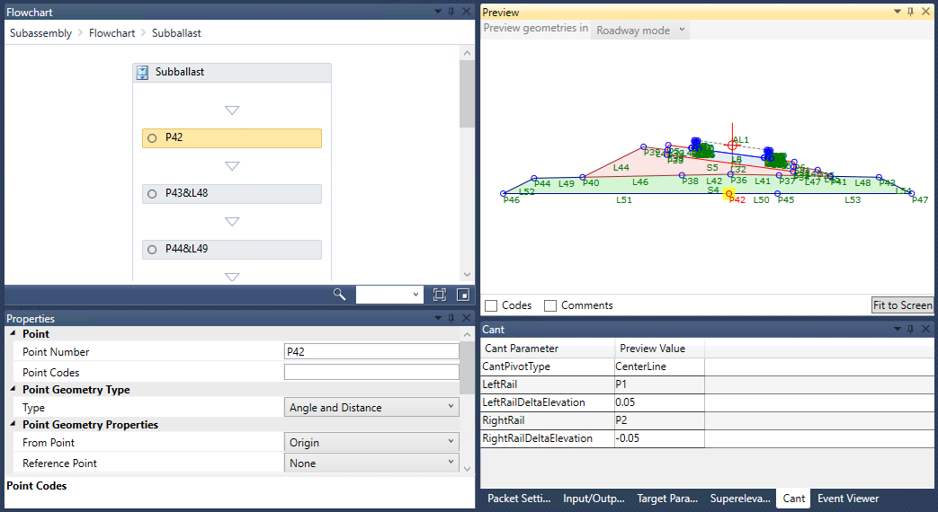

You can define how the cant effect appears in the Preview panel for a rail subassembly by defining cant parameters on the Cant tab. When you define the LeftRail and RightRail parameters, the Subassembly Composer treats the subassembly as a rail assembly and cant values will be applied to it. After you select the ApplyAOR check box in the Properties panel for links to which you want to apply cant, you will see the cant effect in the Preview panel in either Roadway Mode or Layout Mode.
The ApplyAOR check box affects how the subassembly is previewed in the Subassembly Composer and how the subassembly behaves when it is used in Autodesk Civil 3D.
The parameters on the Cant tab are only used to preview the cant effect in the Subassembly Composer. However, to enable some flexibility in defining the geometry, you can define parameters which are referenced by the subassembly when it is used in Autodesk Civil 3D, such as gauge width (double type), on the Input/Output Parameters tab.

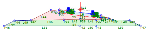

Example
To see an example of how cant is defined, open the following Sample PKT file:
Rail_Cant_Example.pkt
This example shows a rail subassembly.
- A GaugeWidth parameter has been specified on the Input/Output Parameters tab.
- Values to show in the Preview panel are specified on the Cant tab.

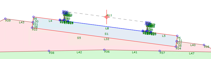

In this example, ApplyAOR is specified for one auxiliary link, AL1, and subsequent points and links that are expected to have a cant effect are made directly or indirectly dependent on AL1 or its points.
Subsequent points and links in the flowchart that are not expected to have a cant effect can be directly or indirectly defined in relation to the origin point (or on points or links that are not directly or indirectly dependent on AL1 or its points).
For example, P42, in the subballast, is defined in relation to the origin and does not have a cant effect.
