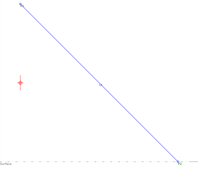

Examples
To see examples of how this geometry element is used, open the following Sample PKT file:
Set Output Parameter Example.pkt
In the example PKT, P2 is drawn on the surface at a specified delta X value from P1. The
Set Output Parameter element uses an API call that gets the slope value from L1. Another subassembly can then refer to the slope value as an input parameter.
