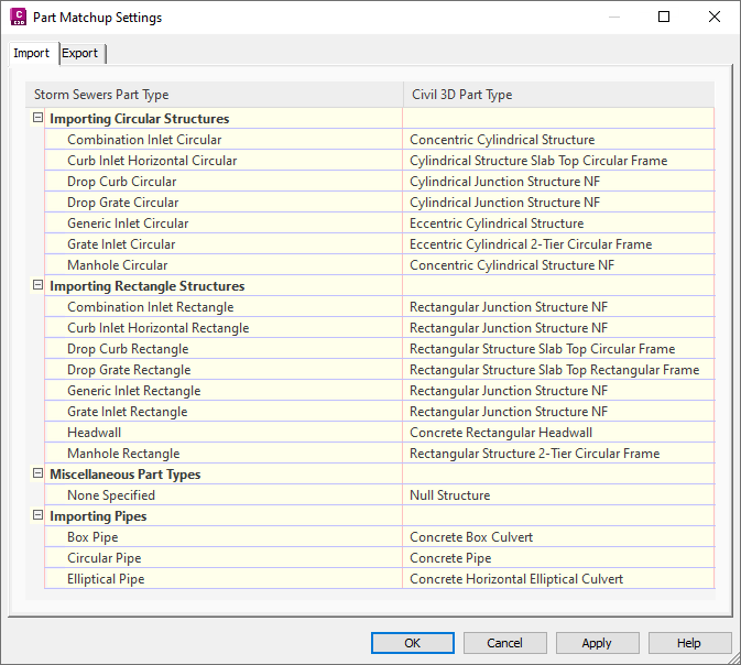

  1. Each Storm Sewers part used is matched with a unique Autodesk Civil 3D Part Family in the Import Tab.

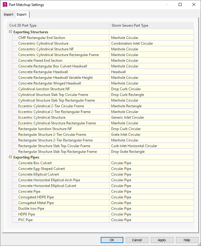

  2. Each of those Autodesk Civil 3D Part Families that match the Storm Sewer parts that are in the STM file are matched to the appropriate Storm Sewer part in the Export tab.
The Autodesk Civil 3D drawing templates contain proposed matching settings as follows:
Import settings:
Export settings:
