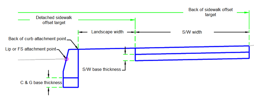

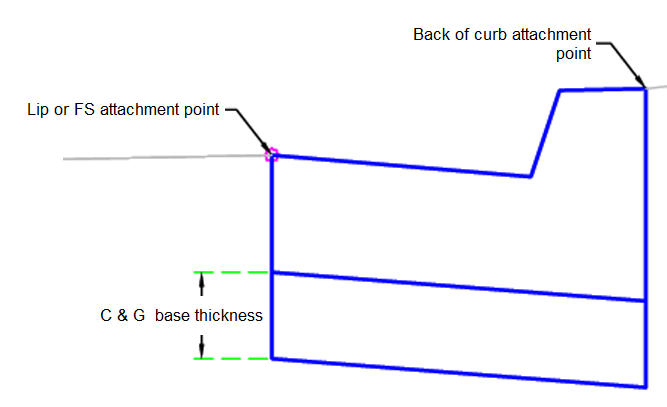

Curb and Gutter:

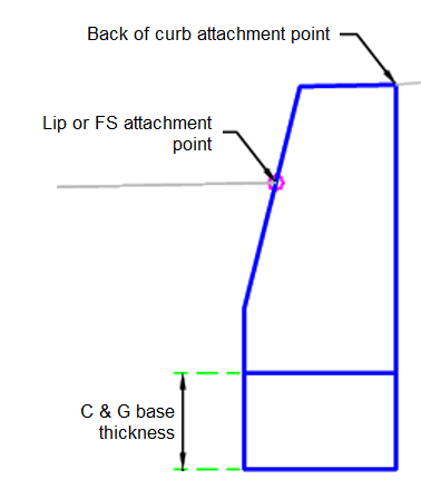

Curb:

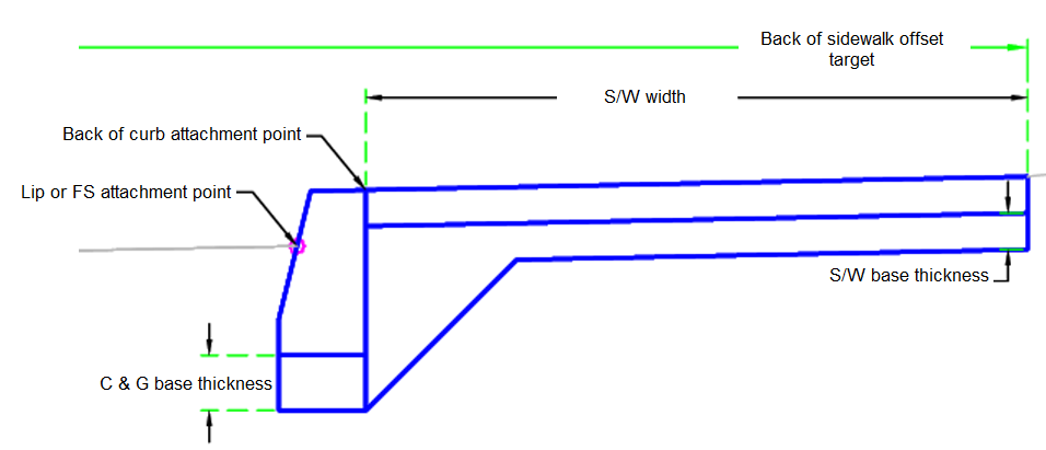

Boardwalk Sidewalk:
Detached Sidewalk:

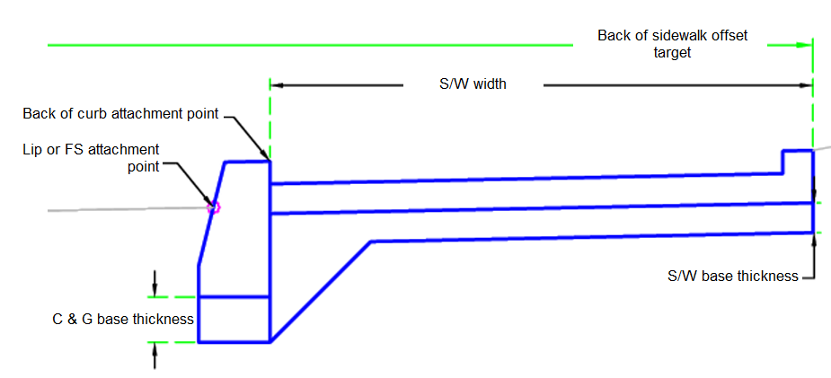

Integral Sidewalk:
The attachment point is at the Lip (or FS) and the Back of Curb. This component can be attached to either the left or right side.
