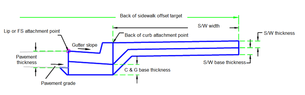

The SLOCountyCurbs subassembly inserts links and shapes to create curbs, gutters, and sidewalks according to the County of San Luis Obispo Standard Plan.
You should verify that the dimensions used match your interpretation of the standard plan.

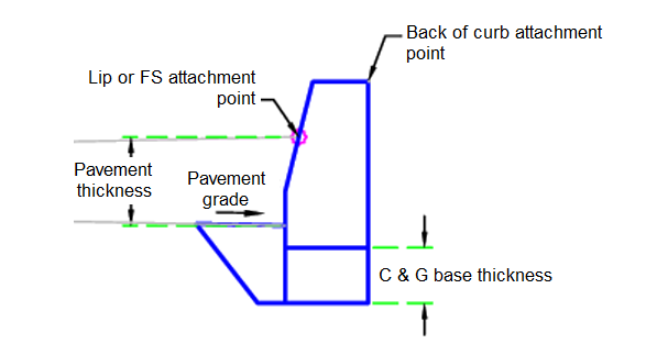

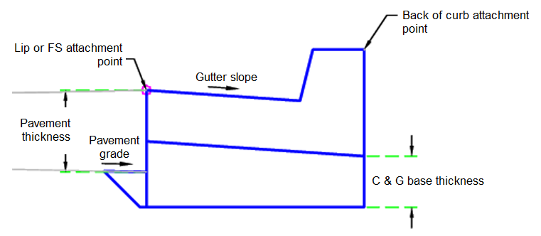

Curb and Gutter:
Curb:

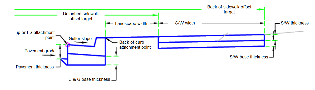

Detached Sidewalk:
Integral Sidewalk:
The attachment point is at the Lip (or FS) and the Back of Curb. This component can be attached to either the left or right side.

| Detached Sidewalk Offset | May be used to override the fixed sidewalk width and tie the inside edge of sidewalk to an offset alignment. The following object types can be used as targets for specifying the width: alignments, polylines, feature lines, or survey figures. | Optional |
| Back of Sidewalk Offset | May be used to override the fixed sidewalk width and tie the outside edge of sidewalk to an offset alignment. The following object types can be used as targets for specifying the width: alignments, polylines, feature lines, or survey figures. | Optional |

If the sidewalk type is not set to None, then the appropriate sidewalk and base is built. If the sidewalk is Detached and the Detached Sidewalk Offset is set, then the inside sidewalk edge is adjusted. If the Back of Sidewalk Offset is set, then the widths of all sidewalk types are adjusted.

Coding Diagram
Curb and Gutter:
Curb:
Detached Sidewalk:
Integral Sidewalk:
