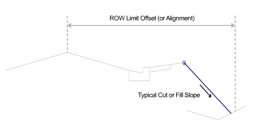

Case 1 is shown in the following illustration.
The typical daylight slope allows the catch point to fall within the offset limit specified either by numeric value, or by the alignment location.

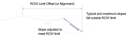

Case 2 is shown in the following illustration.
The typical daylight slope forces the catch point to fall outside the offset limit specified either by numeric value or by the alignment location. If the Hold Slope input parameter is set to Hold Maximum Slope, the slope is increased up to the maximum value. At this point the maximum slope is held and the catch point will be beyond the ROW Limit.

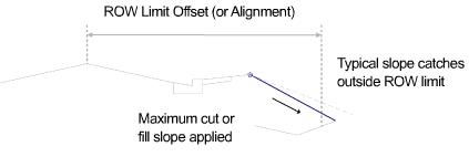

Case 3 is shown in the following illustration.
The typical daylight slope forces the catch point to fall outside the offset limit specified either by numeric value or the alignment location. If the Hold Slope input parameter is set to Override Maximum slope, the slope restrictions are ignored, and the catch point is placed at the ROW offset location.
