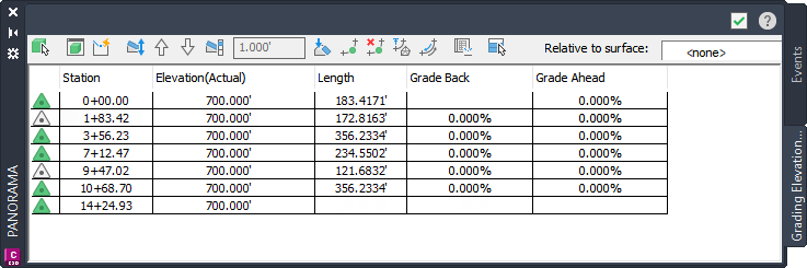

When two feature lines cross at a location where neither one has a PI point, a split point is created. This is displayed in the editor with a white triangle, rather than a green PI triangle.
Figure 1: Elevation Editor, showing two split points
In figure 1, the Elevation Editor shows the elevations for the square feature lines, including two split points where these lines cross other feature lines. In the Elevation Editor, the point symbol in the first column includes a plus sign (+) at any point that intersects with another feature line.
