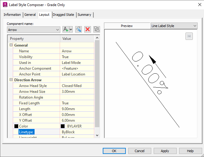

Use an expression to configure the direction arrows in this label style to point in the downhill grade direction, which may be more useful. To do this, edit the Arrow component of the Grade Only style, as shown in figure 6.
Figure 6: Configuring Grade Check arrows in Grade Only label style
To set downhill grade arrows
- In Toolspace, on the Settings tab, expand the General
Label Styles
Line collection. - Right-click Grade Only
Edit. - In the Label Style Composer dialog box, on the Layout tab, select the Arrow component.
- In the Direction Arrow section, click the value for Rotation Angle and select Grade Check.
- Click OK to apply the change.
