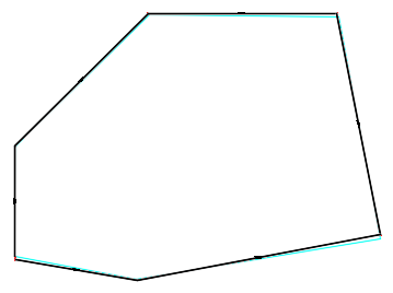

    When the TRV2 file is opened in the dialog box, the default adjustment method graphics are displayed in the drawing. For example, the following illustration shows a traverse with the default color for the compass adjustment type (blue) applied:
