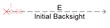

  5. Enter parameters in the first row of the Traverse Editor for the point of beginning (POB).
    Graphics for the initial backsight are displayed in the drawing.

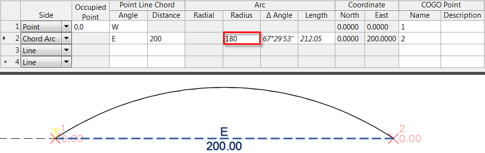

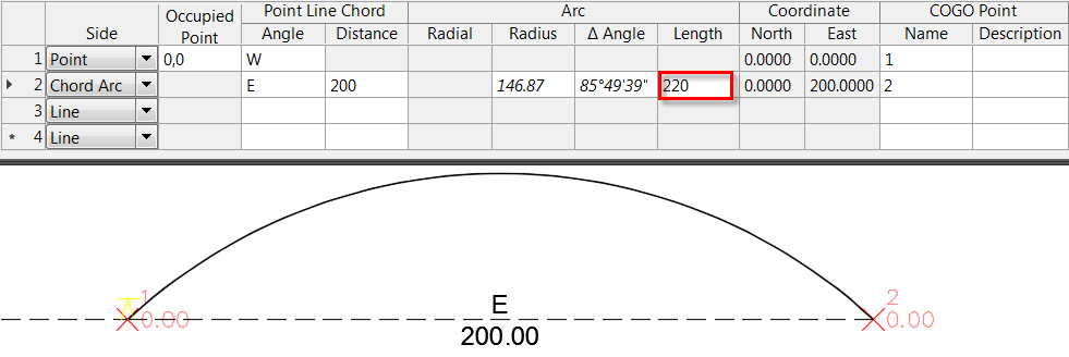

    Entering data for chord arcs
    When entering data for chord arcs, you must specify an angle and distance, and then you can specify either a radius, delta angle, or length. The value you input directly for radius, delta angle, or length is shown in regular font, and calculated values are shown in italics. In the following illustration, 180 was entered for the radius and the delta angle 67° 29' 53" and length 212.05 are calculated.
    You can manually change the values shown in italics to recalculate the other values, which are then shown in italics. In the following illustration, 220 was entered for the length and the radius 146.87 and delta angle 85° 49' 39" were recalculated.

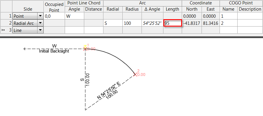

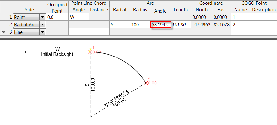

    Entering data for radial arcs
    When entering data for radial arcs, you must specify a radial direction and a radius and either a delta angle or length. The value you input directly for delta angle or length is shown in regular font, and calculated values are shown in italics.
    Changing the radius or delta angle recalculates the length. Changing the length recalculates the delta angle.
    In the following illustration, 58.1945 was entered for the delta angle, and the length 101.80 is calculated.
    In the following illustration, 95 was entered for the length, and the delta angle 54° 25' 52" is calculated.
