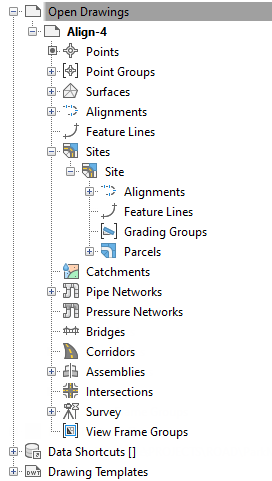

The Prospector Tree
Use the Prospector tree to manage and access drawing and project objects.
The following illustration shows an expanded Prospector tree for a drawing:
Standard context menu commands are available for many Prospector tree items and collections. To display the context menu, right-click a collection or item in the Prospector tree. The following commands are available on the Prospector context menu whenever they are applicable to the selected item(s):
