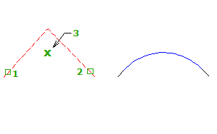

After selecting the two lines (1-2), select the pass-through point (3). The line objects are trimmed to the point of curvature (PC) and the point of tangency (PT).
  1. Click Home tabDraw panelCurves drop-downCreate Curve Through Point Find.
  2. Select the first tangent.
  3. Select the second tangent.
  4. Select the pass-through point.
