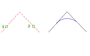

The selected lines are not trimmed to the resulting point of curvature (PC) and point of tangency (PT).
You can use the Curve Calculator to determine the values required for defining the curve.
Click
Find.
- Select the first tangent.
- Select the second tangent.
The following prompt is displayed:
Select entry [Tangent/External/Degree/Chord/Length/Mid-ordinate/miN-dist/Radius] <Radius>:
