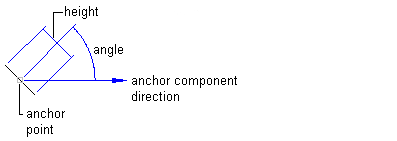

Tick component properties
The following illustrations show the effect of the Align With Object setting for ticks:
  • True. Inserts the tick at an angle relative to the object, as shown in the following illustration:
  • False. Inserts the tick at an angle relative to the UCS setting, as shown in the following illustration:
