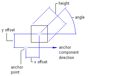

Block component properties

  6. Specify the desired settings in the General and Block categories.
