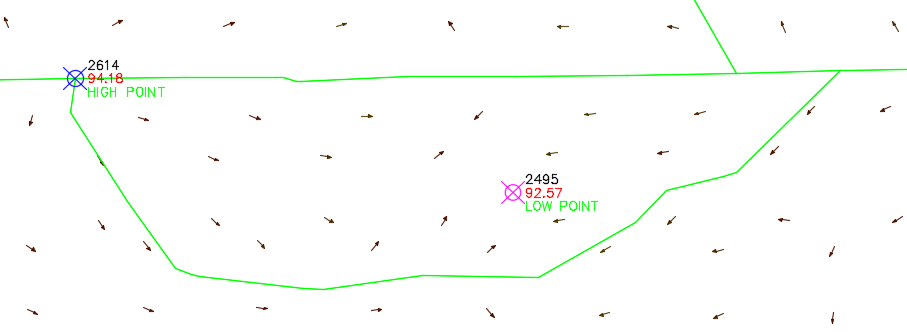

The following illustration shows an example of high and low points that are created for a depression watershed in a surface.
Tip: Use the Display tab in the Surface Style dialog box to turn on the visibility of watersheds and slope arrows in the surface style so you can see the relationship of the points that are created to the watersheds. You can also use the Watersheds tab in the Surface Style dialog box to turn on the display of watershed drain target points to see how the low points correspond to those.
