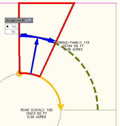

Layout Parcel by Minimum Frontage at an Offset
Now you can use the optional minimum frontage at offset option when creating parcels.
To layout parcels using minimum frontage at an offset
  1. Click Home tabCreate Design panelParcel drop-downParcel Creation Tools to open the Parcel Layout Tools.
  2. Enter the values for Minimum Area, Minimum Frontage, and Frontage Offset.
  3. Set Use Minimum Frontage At Offset to yes.
  4. Choose a creation tool.
  5. In the Create Parcels - Layout dialog box, select the desired site, style, layers, and label styles. Click OK.
  6. Select the parcel area selection label of the parcel that you would like to subdivide. Or you can pick a point within the parcel.
  7. Select start and end points of the frontage line. As you draw along the frontage, a preview line is displayed.
    Figure 7: Frontage preview line
  8. Depending on the tool you selected (Slide Line, Swing Line, and so on) provide the information requested at the Command prompt.
  9. Preview graphics display if the proposed solution is correct. The green dashed line represents the frontage offset as shown in figure 8. Accept the resulting solution or enter No to end the command so that you can adjust the sizing parameters.
    Figure 8: Preview of proposed solution and frontage offset line
    Figure 9: The new parcel is created
