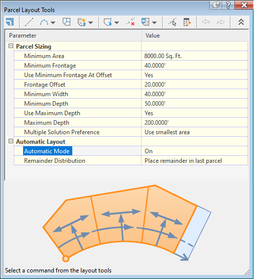

Use the Parcel Layout Tools Automatic Mode option as shown in figure 3 to quickly lay out multiple new parcels. Automatic mode works best with symmetrical areas and regions with uniform shapes. For areas with irregular shapes or tight inside corners, use the manual layout mode.
Figure 3: Set to Automatic Mode
When Automatic Mode is turned on, after you specify the frontage start and end points, the preview graphics display the proposed new parcels, based on the specified criteria. If you accept the proposed solution, such as the example in figure 4, the parcels are created simultaneously.

You can size the parcel by specifying a minimum frontage and a minimum area.
You can use the additional parameters, such as frontage offset, minimum width and depth for even greater precision when you initially lay out the parcels. The parcel sizing parameters allow for a continuous workflow. If you reject a proposed solution, you can simply adjust the parameters and the preview graphics update dynamically.
