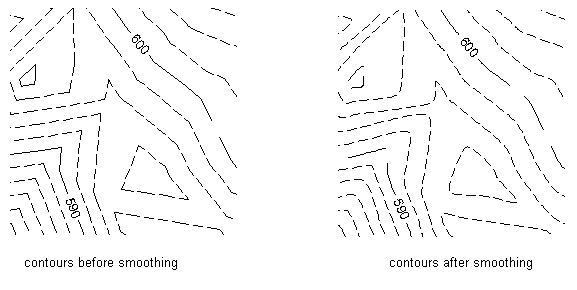

Surface smoothing resolves a problem associated with individual contour smoothing where the smoothing is applied to individual contour lines without regard to adjacent contours, which sometimes creates overlapping contours.
Surface smoothing adds points at system-determined elevations using Natural Neighbor Interpolation (NNI) or Kriging methods, which results in smoothed contours with no overlapping.
Only TIN surfaces support surface smoothing.
Note: TIN volume surfaces do not support editing operations.
Surface smoothing results in smoothed contours with no overlaps:
