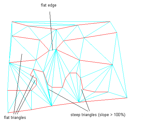

When contour data is added to a TIN surface, the resulting surface can contain flat spots (triangles whose points all come from the same contour) and flat edges (triangle edges that join points from the same contour or from different contours at the same elevation).
The following illustration shows a surface with flat areas where the triangles (in cyan) of a surface are created from red contour lines. Some of the flat triangles and flat edges are indicated:
These flat areas represent inaccuracies in the surface. When the contours of such a surface are displayed, they might not match the original contour data around the flat areas. Also, displayed contours might contain points with three contour segments emanating from them instead of the expected two segments. Use the Minimize Flat Areas operation to find and eliminate triangles that have three points at the same elevation and edges that connect points on different data contours at the same elevation.

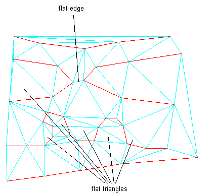

In this illustration, 27 points are added to the surface. Most flat triangles are removed, except for some along the top and upper left borders.

The following illustration shows the same surface after applying both the Adding Points To Flat Triangle Edges and the Adding Points To Flat Edges options. A total of 28 points are added in this example.

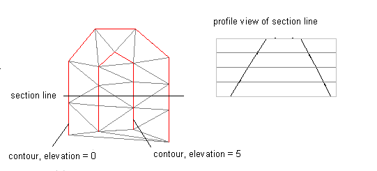

The following illustration shows a surface generated for a ridge where an open contour ends near the border of the surface but not on the border. The contours were added to the surface model with no Minimize Flat Areas. By options specified:

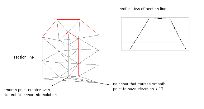

If you run the Minimize Flat Areas operation with the Adding Points to Flat Triangle Edges option, the following results are obtained:
These results occur because the NNI interpolation uses surrounding points to determine an appropriate elevation for a new point. Because all surrounding elevations are lower than the flat triangle, elevations lower than the flat triangle are selected for the added points, resulting in the dip in the ridge.

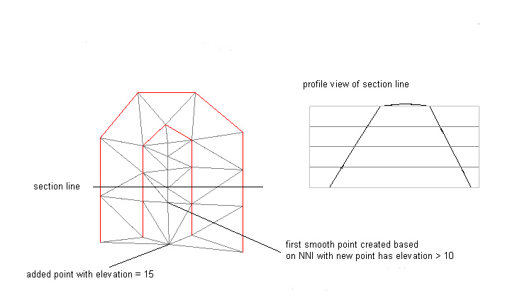

In this instance, you can supplement the contour data by adding a spot elevation point near the open end of the contour, as shown in the following illustration. Then, the Minimize Flat Areas operation generates a crown as desired.
