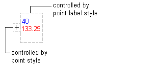

The point style determines the appearance of the point symbol, and the point label style determines how the point is labeled:
