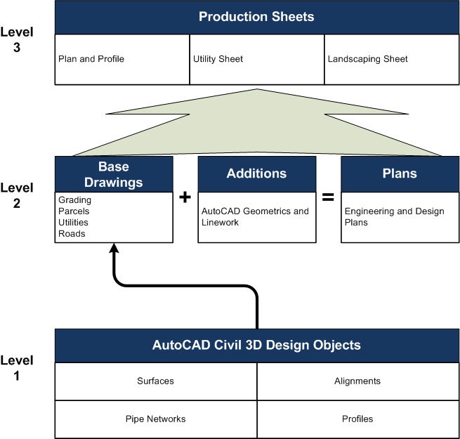

As you create data references between project drawings, you construct a network of drawings. If you are working on a large project with many people, this network can become confusing and difficult to manage. To reap the benefits of data references, it is important to plan the drawing relationships in advance, and actually create a diagram for the project team to reference.
Figure 1: Three-level project drawing structure
Figure 1 shows a sample project structure. You can use this three-level structure with Vault or with data shortcut projects. The following sections describe how to set up the different levels.
