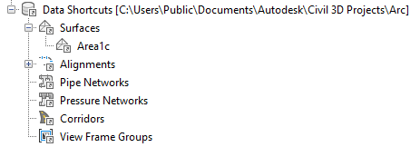

Data Shortcut Projects
If you use data shortcuts, a standard project folder structure is still a best practice. You can use the default template (_Sample Project) and create your own versions.
Default shortcut project template: icons on the Prospector tree
Default shortcut project template: folder structure in the working folder
Keep the top-level _Shortcuts folder and its object-specific subfolders as the storage location for shortcut XML files, but feel free to create other folders for drawings.
