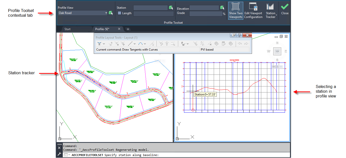

The following illustration shows the Profile Toolset contextual tab as it was invoked while creating a layout profile. When you click the Profile Toolset button on the Transparent ribbon, the Profile Toolset tab is displayed and the drawing viewports are configured to display a plan view and a profile view.
You are first prompted to specify a station. You can select a station by clicking in either plan view or profile view. You can also enter or change the station value in the Station field on the ribbon.
After you specify the station, you are prompted for an elevation. You can move your cursor and click to specify the elevation.
After you specify the first point using a station and elevation, you can then use the other options on the Profile Toolset tab like Length and Grade to continue to draw profile entities.
Profile Toolset Contextual Ribbon Tab
When you click the Profile Toolset button on the Transparent ribbon, the Profile Toolset tab is displayed.
