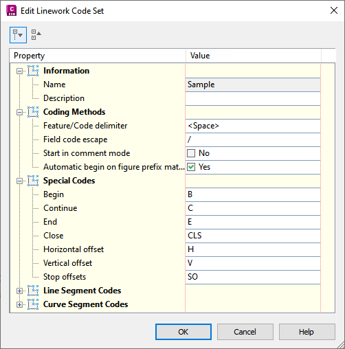

- Use the Linework Code Set dialog box, as shown in figure 1, to specify coding methods and to edit special codes, line segment codes, and curve segment codes.
Figure 1: Specify coding methods for consistency
Note:It is recommended that you use <space> as the Field/Code Delimiter Property value.

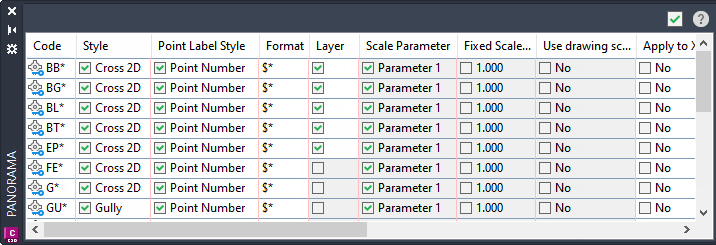

- Use the Description Key editor, as shown in figure 2, to create a suitable description key set to match these codes to style points, label descriptions, and elevations accordingly.
Figure 2: Create description keys editor

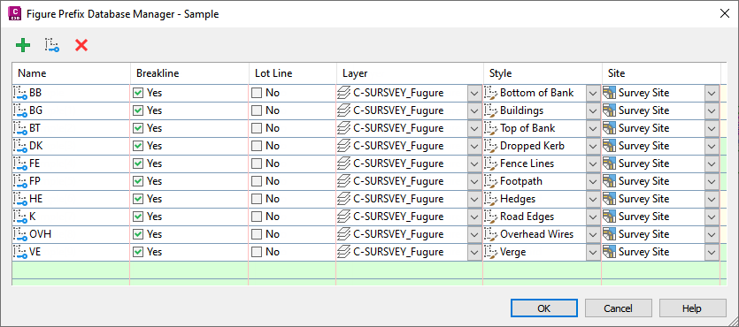

- Use the Figure Prefix Database Manager, as shown in figure 3, to create a figure prefix library and figure styles with which to receive the linework codes and draw the linework in a suitable style.
Note:
You should only specify a site if the Lot Line property is set.
Figure 3: Specify how imported line work is drawn
You can specify whether the linework is drawn as breaklines or lot lines, as well as the assigned layer, style, and site.

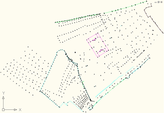

- Import the survey data. The results after importing the survey data into
Autodesk Civil 3D are shown in figure 5.
Figure 5: Imported survey data

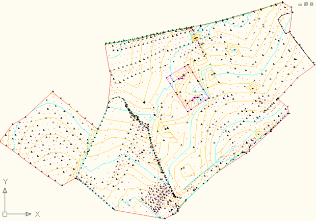

- Create a surface from breaklines and point groups. Then specify a contour style as shown in figure 6.
Figure 6: Surface created from breaklines and point groups with specified contour style
