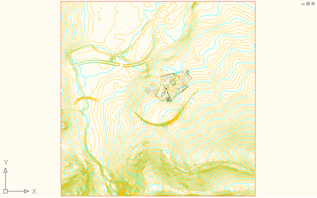

- To fill out the surface, you can use LIDAR contour data which should be set as a 5m grid dataset as shown in figure 7.
Figure 7: LIDAR data used to fill in the surface

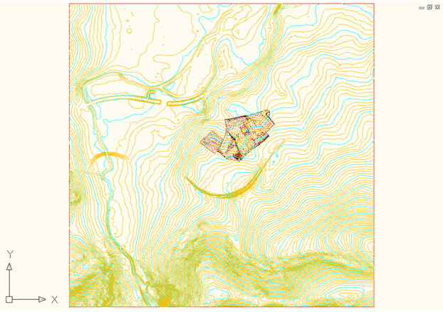

- Create a new surface and paste the 5m grid and also the surveyed surface as shown in figure 8.
Figure 8: Result of pasting the surveyed surface

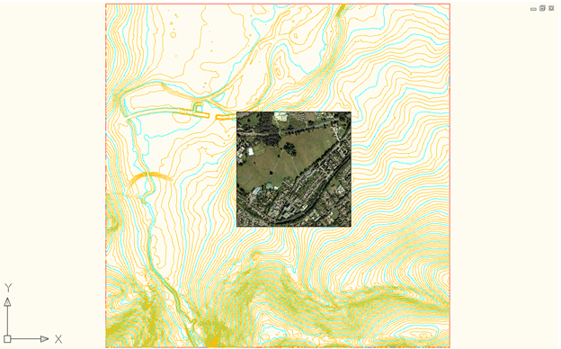

- Using Map import, import the aerial photo of the surveyed field, which includes a “World file” for positioning at the same coordinate system used. The result is shown in figure 9.
Figure 9: Importing the aerial photo

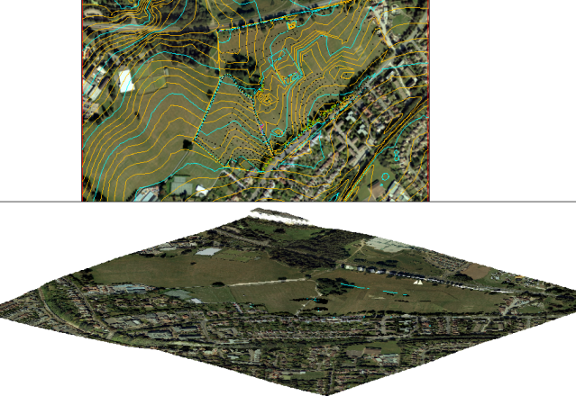

- Create a boundary around the aerial photo and add as a boundary to the composite surface.
Then, drape the aerial photo to the composite surface with the Drape Image command.
Figure 10: Aerial photo added as boundary and draped to the composite surface
