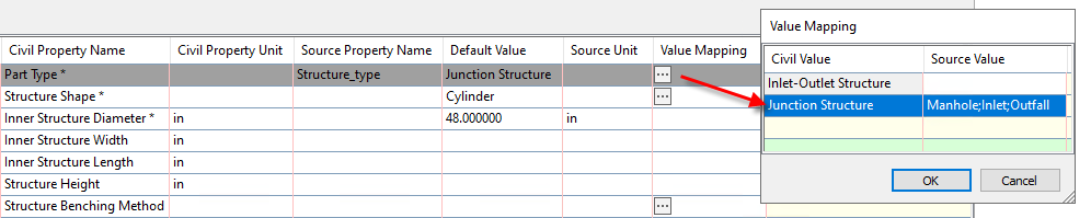

Value Mapping
Opens the Value Mapping dialog box where you can specify Source Property Name values that correspond to Civil 3D properties.
The following example shows how to use the Value Mapping dialog box to map the source values for a "Structure_type" attribute so they are brought into Civil 3D as Junction structures.
The available properties in Civil 3D for the Part Type are Inlet-Outlet Structure and Junction.
If you want to bring in manholes, inlets, and outfalls as Junction part types, you can set up the Value Mapping for the Part Type. For example, if attribute values Manhole, Inlet, and Outfall were specified in the ArcGIS data to indicate the structure type, you can enter those values in the Value Mapping dialog box.
You can include multiple values by separating them with a semicolon. For example, Manhole;Inlet;Outfall. Entries are not case-sensitive.
Note: In the example above, all of these structures will be created in the drawing as generic Junction structures (with a Structure Type of <none>). You can manually set the Structure Type using the Structure Properties dialog box or you can use the Map Drainage Structure Parameters command to assign the Structure Type and other properties.
