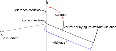

Create a new vertex from an existing vertex in the figure using an azimuth and distance. At least one vertex must exist in the figure for this command to work.

The following illustrates the Azimuth Distance command:
Command Syntax
FIGURE AZ-DIST [azimuth] [distance]
Command Synonym
FIG ZD
| Parameter | Definition |
| azimuth | The desired azimuth from the current vertex to the new vertex. Enter this value in the current survey database angular units, either DMS, grads, decimal degrees, radians, or mils. |
| distance | The distance from the current vertex in the figure to the new vertex. Enter this value in the current survey database distance units. |
