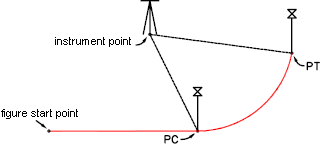

Specify that the next shot is a Point of Curvature (PC) in the current figure. The shot immediately following the next shot is on the Point of Tangency (PT). This command creates a tangential arc from the last leg in the figure.
  1. In Toolspace, on the Survey tab, right-click a named network Survey Command Window.
  2. At the Command line, enter:
    PC
Command Line Example
PC
AD 13 30 25 ! Shot on PC
AD 14 33 24 ! Shot on PT
END
The following illustrates the Point of Curvature command:
Command Syntax
PC
