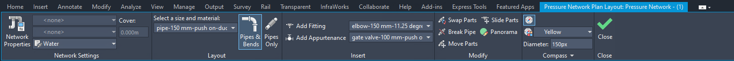

Pressure Network Plan Layout ribbon.
Click Pipes Only
. You are prompted at the command line to specify the first point or enter an elevation.
Note: If you specify a reference surface and Cover value, then the surface elevations and cover value are used to establish the pressure network elevations during the pressure network layout. You can also enter an elevation for the start point (the elevation of the first point specified), which would override the elevation determined by the reference surface and cover. This can be helpful when a design is connecting to an existing network of a known elevation. - On the Network Settings panel on the ribbon, verify that the desired reference surface is selected and that the Cover value is set to the value required for your project.
- On the Layout panel on the ribbon, specify the size and material for the pressure network pipes.
