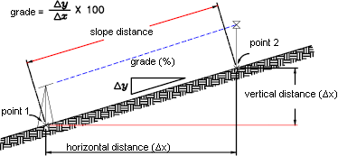

Use the Grade command to determine the grade between two points. You must specify a starting point and an ahead point.

Grade: 1.0776 Percent
This example displays the grade from point 1 to point 2 in percent. When used as a built-in function, this command supplies the vertical angle in the current vertical reference system (zenith, nadir, or horizontal).
