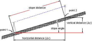

    The following illustration shows the Slope Distance command:

point 1 and point 2 These are the two existing points between which an invisible line is established. This line is used to determine the slope distance between the two points.
